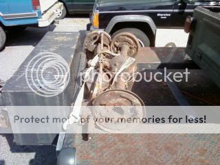

Post by BIG J on Oct 2, 2009 10:40:58 GMT -5
more simple things: narrow axles, and a wrangler tub also got Derek's old lift springs.....things are starting to get complicated; might have to try to squeeze the Qs in there.........

Post by JeepCJ5 on Oct 2, 2009 15:25:47 GMT -5
With the narrow axles and those old Rancho springs the Q's might tuck right in there.. I had the same, except I had 2" body lift and 1/2 shackle lift.
