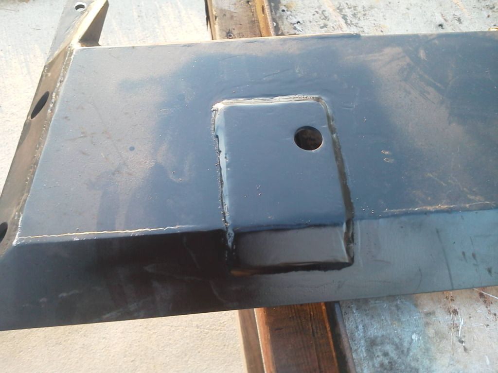

I don't know if I would say it warrants a concern, but it would be horizontal forces pushing and pulling that tube over time. I was thinking a gusset would make sure to keep it from cracking around the welds. But if the tire is kind of clamped down on the frame ten no worries.

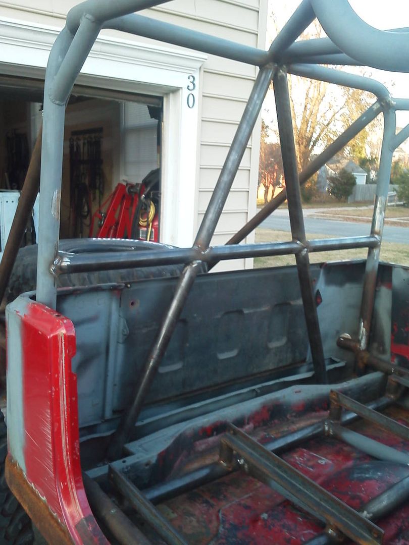

Post by PaulC on Nov 12, 2012 19:13:51 GMT -5

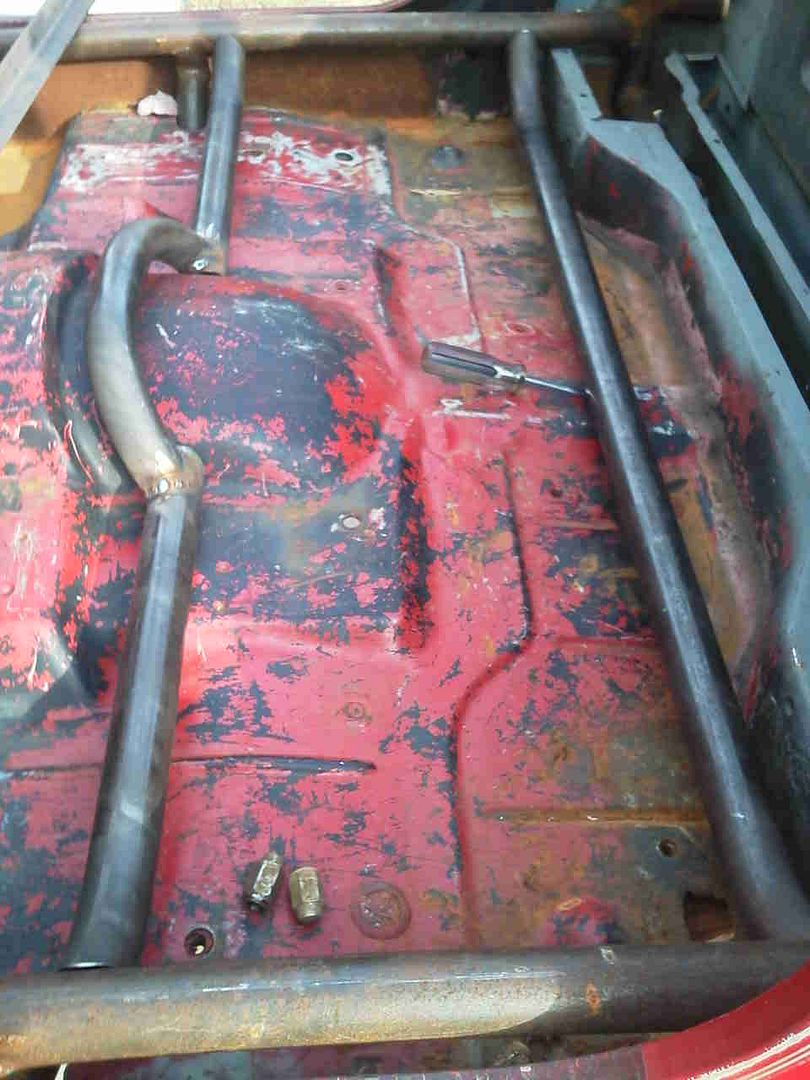

Finally some nice weather. Had a nice relaxing veterans day, thank you to all that have served, and made the seat cross bars. Hopefully the weather holds and Jim can come over tomorrow and we can get the seat mounts made to make him comfortable. PaulC

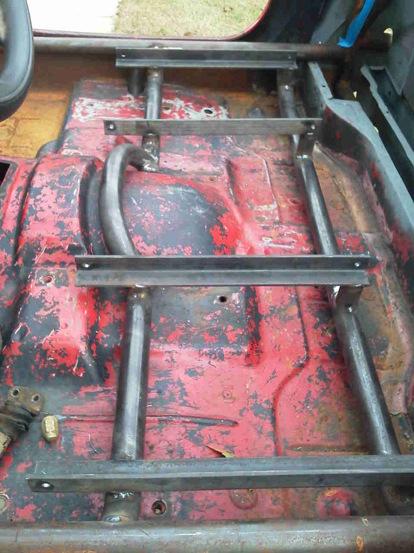

Jim came over today so we could fit the seats and make the mounting brackets. Got them done and welded in. Here he is, the proud owner. PaulC

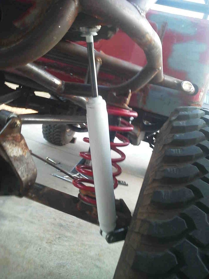

Post by PaulC on Nov 29, 2012 17:08:58 GMT -5
Another end of week update. Got the rear shocks mounted and bolted up. Also capped the tubing that was cut to give rear tire clearance. Dropped the cross member and filled in the hole that was cut out for transfer case clearance. The hole left in it is to access the Dana 300 drain plug. Had to rework the B pillar X support and cross bar for more head room and to get correct positioning for the shoulder belts of the 5 point harness. Now all that is left from me for now is to get the rear driveshaft done and make a grab bar for the passenger side. PaulC

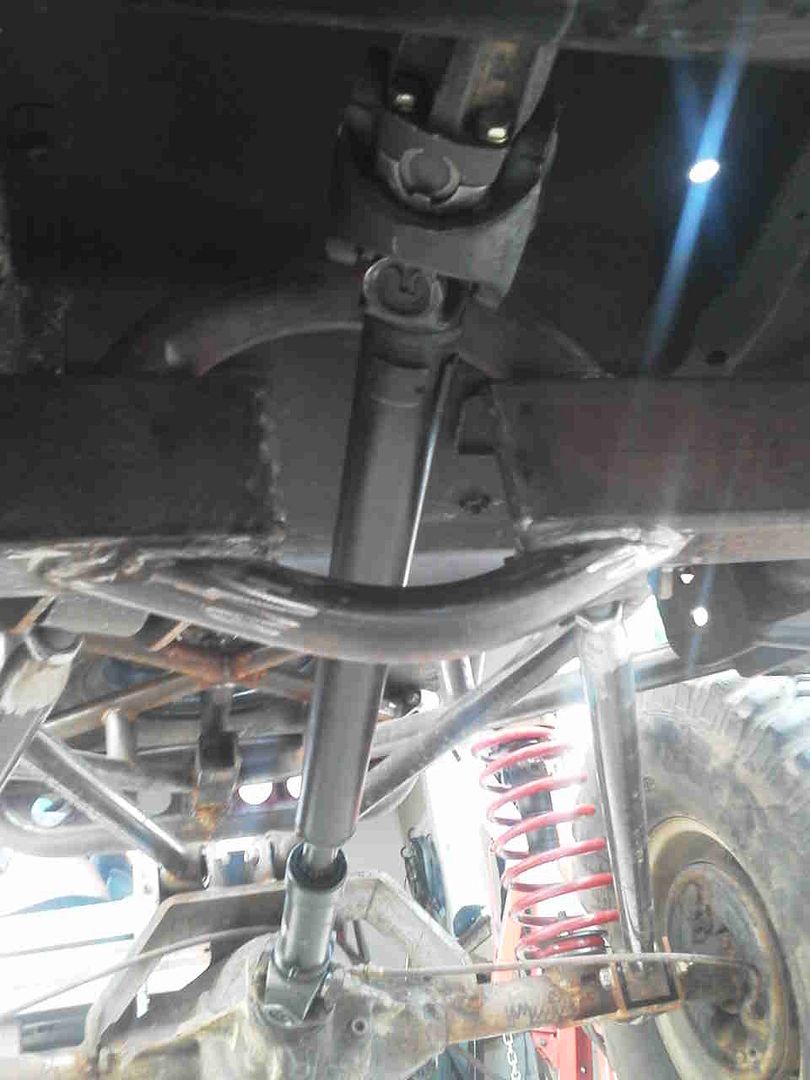

Post by PaulC on Dec 4, 2012 16:31:11 GMT -5
Happy Birthday Jim. How young are you? Dropped the drive shaft off yesterday at Craft Machine and they finished it today. I've never had a problem with their work. One thing left for me to do, passenger side grab bar and then the Jeep is off to Jim's house. PaulC

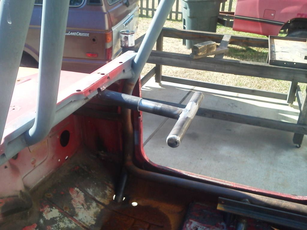

Post by PaulC on Dec 6, 2012 14:02:00 GMT -5
Well, Finished the passenger grab bar today. Now the Jeep is off to Jim's house. PaulC

Post by ScramblerPat on Dec 7, 2012 3:12:09 GMT -5
Very nice work Paul! I am looking forward to see it wheelin. Why did you keep the leafs up front and put links in the rear?

Post by PaulC on Dec 8, 2012 20:02:46 GMT -5
Norm, I remember that roll over. That was funny as all get out. Pat, It just wasn't in the budget to do coils and links up front. Maybe when he breaks the Dana 30 front and we swap in a Dana 44. Well, Jim picked up his CJ today. He looks pretty happy, Caleb is probably thinking "Only if I had a Jeep with a full frame" Adam, I have idea what he is thinking. PaulC
