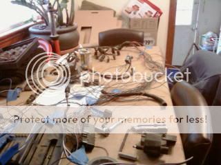

Post by BIG J on Jun 3, 2009 16:23:55 GMT -5
making sense of the wiring
Post by toynrnd on Jun 3, 2009 16:46:07 GMT -5
Uh...shouldn't some of those wires be attached to the Jeep?
Post by BIG J on Jun 6, 2009 15:55:54 GMT -5
they are now; i should be able to start it this weekend if i can get the tranny cross member finished, and the fuel pump in. i figured if Kenny can do it I can do it
Post by ScramblerPat on Jun 6, 2009 19:22:35 GMT -5
Why did you need to pull the wiring harness out of the CJ for a KISS 258 replacement??
Post by BIG J on Jun 7, 2009 7:34:36 GMT -5
that harness is from the 4.0 it had a carb'd 151 that stopped running; so i got a 98 4.0, ax-15, d300 in it now. it is a simple swap, and since i used the ax-15 i didn't have to buy the expensive CPS relocation kit; and the 300 bolted up to the ax-15 with a simple spacer. so it was probably only a little more expensive than droping in a 258. more power, better milage, no smoke. the only fab i had to do was the tranny crossmember; and that too was fairly simple
